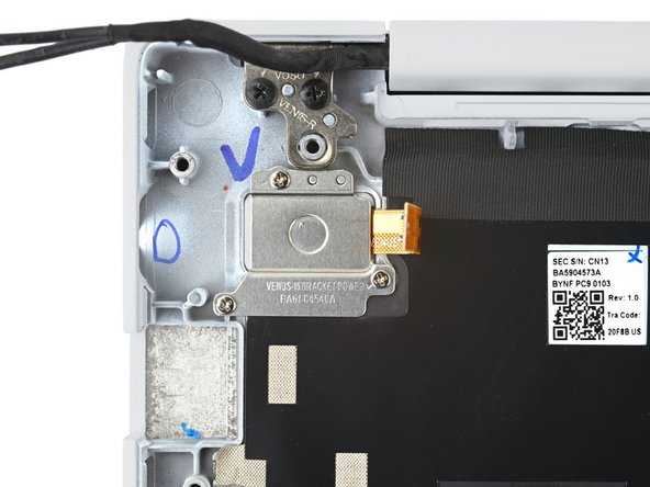

    1. Samsung Galaxy Book Pro 15" Fingerprint Sensor Replacement, Unfasten the fingerprint sensor bracket: step 18, image 1 of 2 Samsung Galaxy Book Pro 15" Fingerprint Sensor Replacement, Unfasten the fingerprint sensor bracket: step 18, image 2 of 2
      • Use a Phillips #00 screwdriver to remove the three 2.4 mm-long screws securing the fingerprint sensor bracket.
      Ask FixBot
    2. Samsung Galaxy Book Pro 15" Fingerprint Sensor Replacement: step 19, image 1 of 1
      Tool used on this step:
      Buy
      • Use tweezers, or your fingers, to remove the fingerprint sensor bracket.
      Ask FixBot
    3. Samsung Galaxy Book Pro 15" Fingerprint Sensor Replacement, Remove the fingerprint sensor: step 20, image 1 of 3 Samsung Galaxy Book Pro 15" Fingerprint Sensor Replacement, Remove the fingerprint sensor: step 20, image 2 of 3 Samsung Galaxy Book Pro 15" Fingerprint Sensor Replacement, Remove the fingerprint sensor: step 20, image 3 of 3
      • Use tweezers, or your fingers, to lift the fingerprint sensor out of its recess in the frame.
      • Remove the fingerprint sensor.
