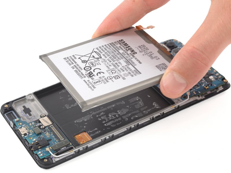

    3. Samsung Galaxy A51 Battery Replacement: step 18, image 1 of 1
      • Apply an iOpener for 2-3 minutes to the battery to loosen the adhesive beneath the battery. Apply the iOpener for 2-3 minutes.
      • You may need to repeat this procedure several times during the battery removal.
      Ask FixBot
    4. Samsung Galaxy A51 Battery Replacement: step 19, image 1 of 3 Samsung Galaxy A51 Battery Replacement: step 19, image 2 of 3 Samsung Galaxy A51 Battery Replacement: step 19, image 3 of 3
      Tool used on this step:
      Plastic Cards
      $2.99
      Buy
      • Try your best not to deform the battery during this process. Soft-shell lithium-ion batteries can leak dangerous chemicals, catch fire, or even explode if damaged. Do not use excessive force or pry at the battery with metal tools.
      • Insert a plastic card underneath the bottom edge of the battery.
      • Carefully slide it underneath the battery to loosen the adhesive.
      Ask FixBot
    5. Samsung Galaxy A51 Battery Replacement: step 20, image 1 of 1
      • Remove the battery.
      • Do not reinstall a damaged or deformed battery, as doing so is a potential safety hazard.
      Ask FixBot
