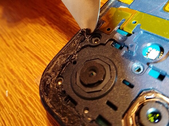

    2. Samsung Galaxy A16 5G Display Replacement, Remove back cover: step 2, image 1 of 3 Samsung Galaxy A16 5G Display Replacement, Remove back cover: step 2, image 2 of 3 Samsung Galaxy A16 5G Display Replacement, Remove back cover: step 2, image 3 of 3
      • Be careful now: The seals are quite sticky and you may damage the antenna with the metal spudger! The problematic zones are marked in red.
      • Remove the back cover. I removed it with a metal spudger. You may be able to soften the seals with a heat plate, but I decided not to since it is a plastic back cover.

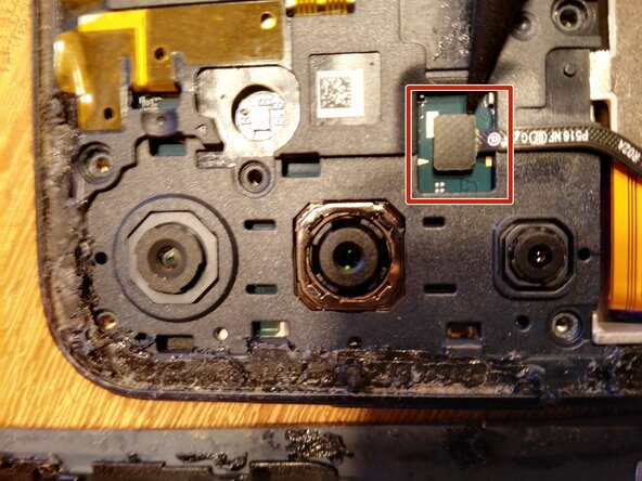

    3. Samsung Galaxy A16 5G Display Replacement, Unscrew top of display: step 3, image 1 of 2 Samsung Galaxy A16 5G Display Replacement, Unscrew top of display: step 3, image 2 of 2
      • Remove 8 top screws with a Phillips head screw driver J000
      • Remove cable with a plastic spudger

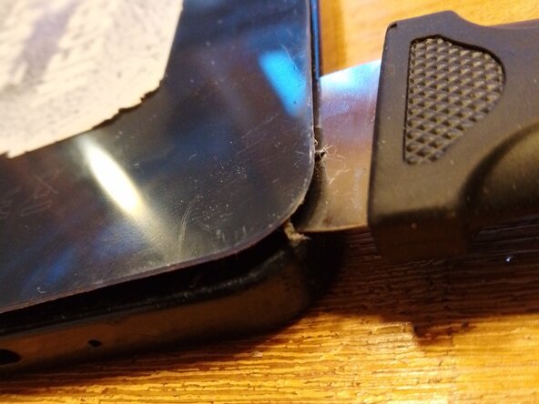

    5. Samsung Galaxy A16 5G Display Replacement, Remove frame: step 5, image 1 of 2 Samsung Galaxy A16 5G Display Replacement, Remove frame: step 5, image 2 of 2
      • Remove frame from display with a spudger. A metal spudger is used in image. Be careful at the volume buttons, on/off switch and the USB-C cable input.
      • There is no plug that combines both parts, so just lay them next to each other.

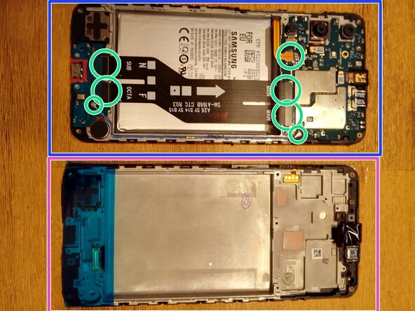

    6. Samsung Galaxy A16 5G Display Replacement, Remove cables: step 6, image 1 of 3 Samsung Galaxy A16 5G Display Replacement, Remove cables: step 6, image 2 of 3 Samsung Galaxy A16 5G Display Replacement, Remove cables: step 6, image 3 of 3
      • Lay the old display component (blue) next to the new one (pink).
      • Remove 7 plugs of cables in the old display component with a plastic spudger.
