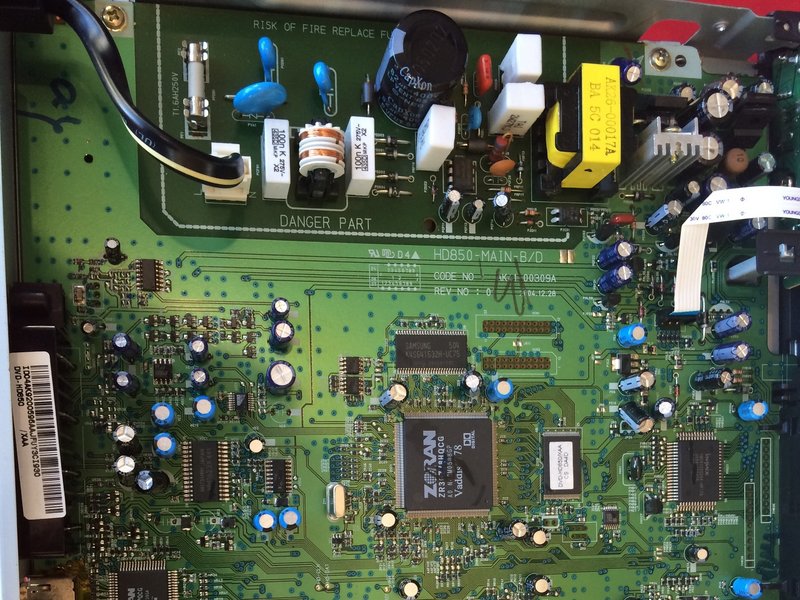

    1. Samsung DVD-HD850 Player Fuse Replacement, Locate the Circuit Board: step 4, image 1 of 1
      • Make sure your device is unplugged before you try to do the following steps to avoid electrocution
      • It is recommended to buy the new power fuse before proceeding with this guide. To buy a power fuse online you can click on the name of the fuse under the "relevant parts" section on the top of this page and it will guide you to a website to buy one
      • With the back panel of the device facing towards you, locate the circuit board inside the device
      Ask FixBot
    2. Samsung DVD-HD850 Player Fuse Replacement, Locate the Power Fuse: step 5, image 1 of 1
      • Locate the power fuse on the bottom left of the circuit board
      Ask FixBot
    3. Samsung DVD-HD850 Player Fuse Replacement, Remove the Power Fuse: step 6, image 1 of 1
      • To Remove the power fuse from the circuit board, gently pull up on the fuse to remove it from the metal clips
      • The power fuse is very delicate so do not put much force into pulling it from the clips

    4. Samsung DVD-HD850 Player Fuse Replacement, Insert the new Power Fuse: step 7, image 1 of 1
      • After removing the old power fuse, put in the new fuse by gently pushing the fuse into the metal clips until it clicks into place
      • The best way to put the new fuse in is by grabbing both ends of the fuse and pushing it in from the ends. Avoid pushing it in from the middle of the fuse to prevent it from breaking
      • If done correctly you should now have full power back in your device!
      • Do not try to power the device on before reassembling the device first
