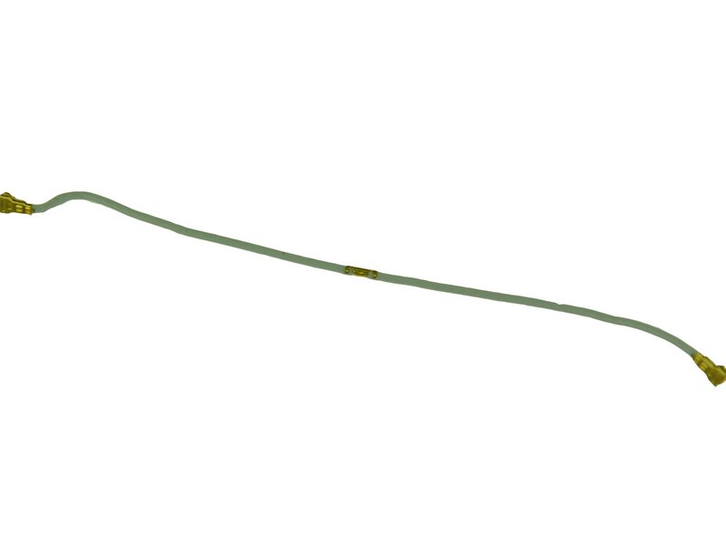

If your Samsung Captivate is not connecting to the network, one problem could be a faulty antenna cable. Replacing this part is very simple and can be accomplished by anyone.

    1. Samsung Captivate Antenna Cable Replacement, Antenna Cable: step 8, image 1 of 2 Samsung Captivate Antenna Cable Replacement, Antenna Cable: step 8, image 2 of 2
      • Use a spudger tool to pry up the antenna cable from the connector on the motherboard.
      • Pry up the other end of the cable from the connector on the antenna array.
      Ask FixBot

Quick question, is this the antenna for wifi or cellular network?
Michael Perdomo - Reply Share
This is actually just the cable that connects the motherboard to the antenna array. I believe the antenna array that it connects to is for WiFi though.
Drew Bentz - Reply Share
