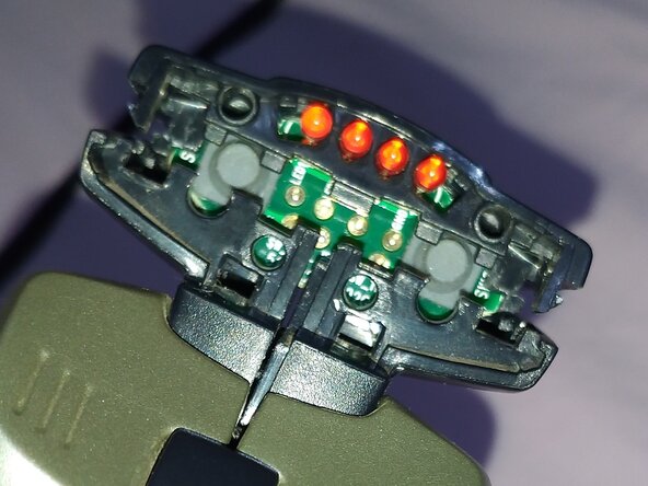

    2. Saitek ST90 PS22 Disassembly Guide, Remove blue display.: step 2, image 1 of 2 Saitek ST90 PS22 Disassembly Guide, Remove blue display.: step 2, image 2 of 2
      • Using a screwdriver or equivalent tool, remove the blue display.
      • Its clips are on the side of the blue display.
      • Press the sides inward.
      Ask FixBot

    4. Saitek ST90 PS22 Disassembly Guide, Hidden plastic clips of the top buttons.: step 4, image 1 of 2 Saitek ST90 PS22 Disassembly Guide, Hidden plastic clips of the top buttons.: step 4, image 2 of 2
      • Locate the plastic hidden clips of the top buttons.
      • obs: I started by releasing the large buttons by their side latches, then I discovered that releasing the hidden latches in a UU-shape also allows you to release the button.

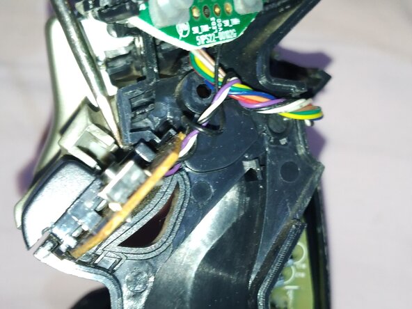

    6. Saitek ST90 PS22 Disassembly Guide, Separate the two halves of the handle.: step 6, image 1 of 2 Saitek ST90 PS22 Disassembly Guide, Separate the two halves of the handle.: step 6, image 2 of 2
      • Always be careful, because of the wiring.

    7. Saitek ST90 PS22 Disassembly Guide, Access trigger, spring and internal wiring.: step 7, image 1 of 3 Saitek ST90 PS22 Disassembly Guide, Access trigger, spring and internal wiring.: step 7, image 2 of 3 Saitek ST90 PS22 Disassembly Guide, Access trigger, spring and internal wiring.: step 7, image 3 of 3
      Ask FixBot

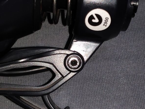

    11. Saitek ST90 PS22 Disassembly Guide, Remove the feet from the base.: step 11, image 1 of 3 Saitek ST90 PS22 Disassembly Guide, Remove the feet from the base.: step 11, image 2 of 3 Saitek ST90 PS22 Disassembly Guide, Remove the feet from the base.: step 11, image 3 of 3
      • 1- Locate the footrest and the base.
      • 2-Unscrew it using a small TORX key.
      • obs: Pay attention to the nut on the opposite side of the bolt.
      Ask FixBot
