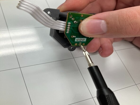

    4. SAFFUN Wireless N64 Controller Joystick Replacement: step 8, image 1 of 3 SAFFUN Wireless N64 Controller Joystick Replacement: step 8, image 2 of 3 SAFFUN Wireless N64 Controller Joystick Replacement: step 8, image 3 of 3
      • Use a Phillips #1 screwdriver to remove the remaining 3.9 mm screw from the center of the joystick board.
      • Set aside the joystick board.
