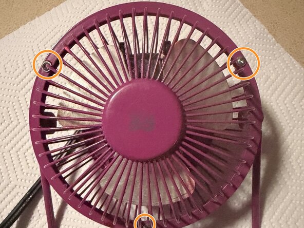

    1. Room Essentials FE10-CP Fan Motor Replacement Guide, Fan Motor: step 1, image 1 of 2 Room Essentials FE10-CP Fan Motor Replacement Guide, Fan Motor: step 1, image 2 of 2
      • Remove the three top screws securing the front grille to expose the fan blades.

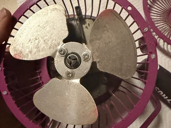

    2. Room Essentials FE10-CP Fan Motor Replacement Guide: step 2, image 1 of 3 Room Essentials FE10-CP Fan Motor Replacement Guide: step 2, image 2 of 3 Room Essentials FE10-CP Fan Motor Replacement Guide: step 2, image 3 of 3
      • Gently grasp the fan blades to avoid bending them.
      • Remove the three screws securing the fan to the motor shaft.
      • Gently wiggle the fan loose and set it aside.
      Ask FixBot

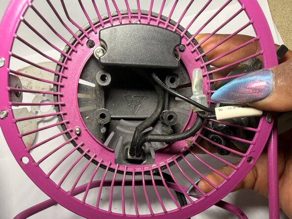

    4. Room Essentials FE10-CP Fan Motor Replacement Guide: step 4, image 1 of 2 Room Essentials FE10-CP Fan Motor Replacement Guide: step 4, image 2 of 2
      • Lift the motor assembly out of the housing.
      • Verify that the fan housing looks like the image shown before moving to the next step.
      Ask FixBot

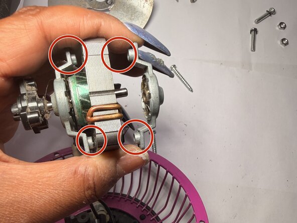

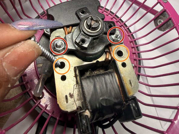

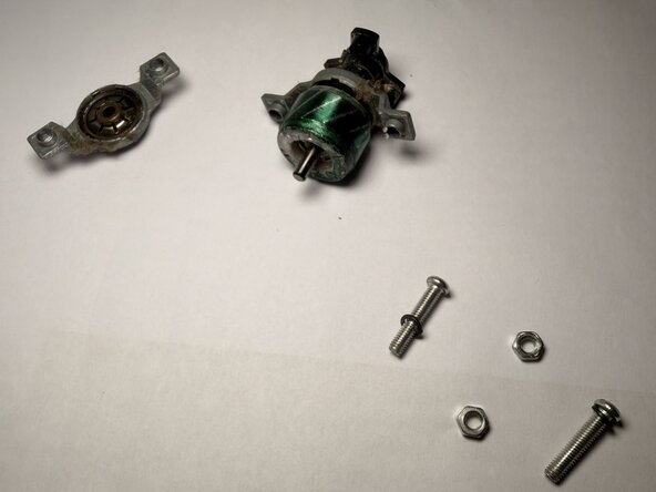

    5. Room Essentials FE10-CP Fan Motor Replacement Guide: step 5, image 1 of 1
      • Remove the two Phillips screws and matching nuts securing the motor, fan blade assembly, and motor cover together.
      Ask FixBot

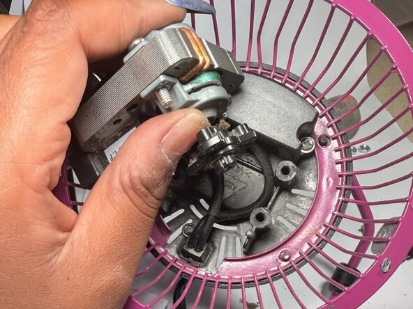

    6. Room Essentials FE10-CP Fan Motor Replacement Guide: step 6, image 1 of 1
      • Remove the motor cover and set it aside.
      • Carefully lift the motor out of the frame.
      Ask FixBot
