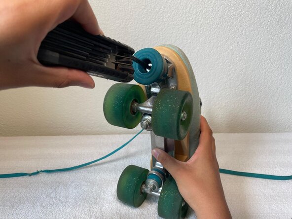

      • Position your rollerskate so the heel is touching the table and the toe stop is facing you.
      Ask FixBot
    2. Roller Skate Bullseye Toe Stop Replacement: step 2, image 1 of 3 Roller Skate Bullseye Toe Stop Replacement: step 2, image 2 of 3 Roller Skate Bullseye Toe Stop Replacement: step 2, image 3 of 3
      • Insert a 5 mm Allen wrench/hex key into the bolt located within the toe stop hole.
      • Loosen the bolt by turning the hex key to the left.

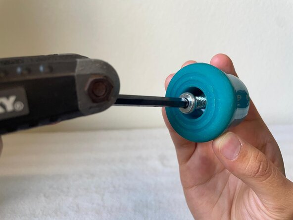

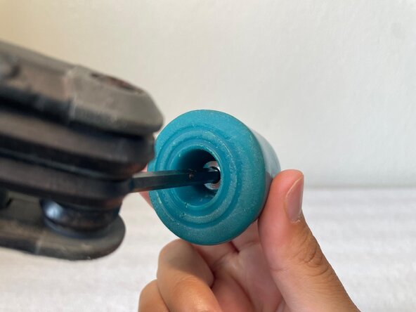

    5. Roller Skate Bullseye Toe Stop Replacement: step 5, image 1 of 3 Roller Skate Bullseye Toe Stop Replacement: step 5, image 2 of 3 Roller Skate Bullseye Toe Stop Replacement: step 5, image 3 of 3
      • Hold the toe stop with one hand, and the Allen wrench with the other.
      • Insert the 5mm Allen wrench into the bolt at the center of the toe stop hole.
      • Use one finger from the hand holding the toe stop to apply gentle pressure against the point of the bolt.
      • This pressure will allow you to successfully unscrew the bolt from the toe stop, otherwise the bolt will not unscrew.
      • Unscrew the bolt from the toe stop by turning the Allen wrench to the left.
      Ask FixBot
    6. Roller Skate Bullseye Toe Stop Replacement: step 6, image 1 of 3 Roller Skate Bullseye Toe Stop Replacement: step 6, image 2 of 3 Roller Skate Bullseye Toe Stop Replacement: step 6, image 3 of 3
      • Continue to apply pressure to the point of your toe stop as you unscrew the bolt from the toe stop.
      • Continue to unscrew until the bolt and washer are removed from the toe stop.

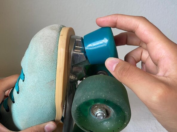

    11. Roller Skate Bullseye Toe Stop Replacement: step 11, image 1 of 2 Roller Skate Bullseye Toe Stop Replacement: step 11, image 2 of 2
      • Screw the toe stop into the skate hole with your hand.
      Ask FixBot
    12. Roller Skate Bullseye Toe Stop Replacement: step 12, image 1 of 3 Roller Skate Bullseye Toe Stop Replacement: step 12, image 2 of 3 Roller Skate Bullseye Toe Stop Replacement: step 12, image 3 of 3
      • Use the Allen wrench to tighten the toe stop into the skate.
      • Beware of overtightening the bolt; doing so will cause damage to the threads of the bolt and within the skate. Only tighten the toe stop until it cannot be unscrewed by hand.
      Ask FixBot
    13. Roller Skate Bullseye Toe Stop Replacement: step 13, image 1 of 1
      • Test the toe stop's tightness by trying to unscrew the toe stop by hand. If you cannot unscrew the toe stop, you know it's tight enough.
