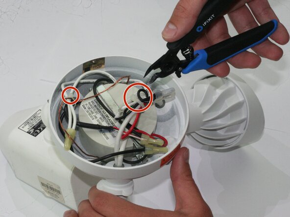

    1. Ring Floodlight Cam Floodlight Replacement, Floodlight: step 3, image 1 of 1
      • Cut the zip ties surrounding the wires.
      • This step is not necessary if the zip ties were previously cut during the installation of the device.
