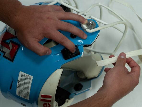

    1. Riddell Speedflex Football Helmet Chinstrap Replacement, Chinstrap: step 1, image 1 of 2 Riddell Speedflex Football Helmet Chinstrap Replacement, Chinstrap: step 1, image 2 of 2
      • Place your helmet on a reliable, flat, sturdy surface to ensure an easy removal and replacement process.
      • Position the helmet so that the side closest to you is off the table.

    2. Riddell Speedflex Football Helmet Chinstrap Replacement: step 2, image 1 of 2 Riddell Speedflex Football Helmet Chinstrap Replacement: step 2, image 2 of 2
      • Use a Phillips #1 to loosen the strap-loc screw at the top corner of the helmet.
      • The strap loc screw is the screw that is located just behind the farthest part of the facemask.
      • Repeat on the opposite side of the helmet.

    3. Riddell Speedflex Football Helmet Chinstrap Replacement: step 3, image 1 of 2 Riddell Speedflex Football Helmet Chinstrap Replacement: step 3, image 2 of 2
      • Pull the top part of your chinstrap up underneath both strap-loc systems.
      • If you are having a difficult time sliding the chinstrap underneath the strap-loc system, loosen the screw just a bit more.

    4. Riddell Speedflex Football Helmet Chinstrap Replacement: step 4, image 1 of 2 Riddell Speedflex Football Helmet Chinstrap Replacement: step 4, image 2 of 2
      • With your thumb, press down onto the cam-loc system’s switch.
      • When you do so, you should hear a faint "click" sound. This means that the cam-loc system is open.
      • With your free finger, pull the chinstrap through the cam-loc system until the entire unit is fully out.
      Ask FixBot
    5. Riddell Speedflex Football Helmet Chinstrap Replacement: step 5, image 1 of 2 Riddell Speedflex Football Helmet Chinstrap Replacement: step 5, image 2 of 2
      • Repeat steps 3-4 on the other side of the helmet.
      • At this point, your chinstrap should now be completely free from the helmet itself.
