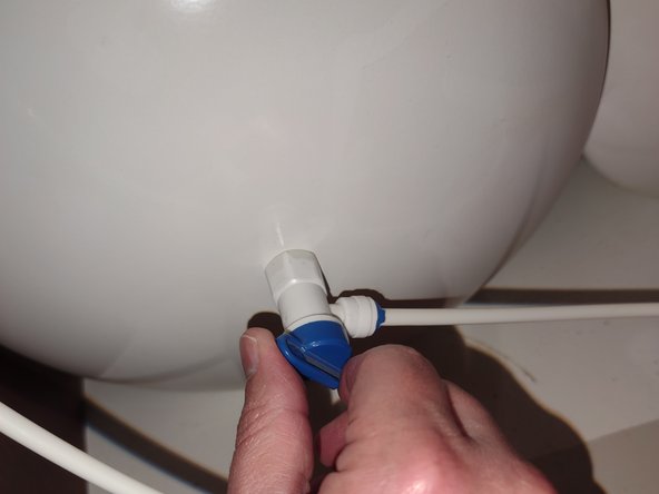

    4. Reverse Osmosis Filter Reservoir Pressure, Close the output valve of the reservoir: step 5, image 1 of 1
      • Close off the output valve for the reservoir
      • For most RO unit reservoirs, this is a ball valve on the top of the reservoir
      Ask FixBot
