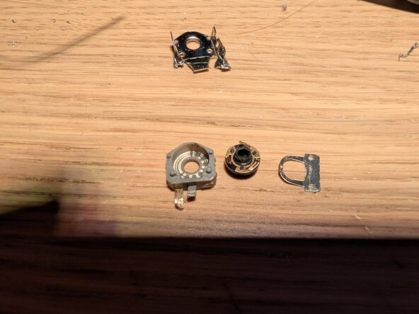

  4. Replacing the scroll wheel encoder on the Logitech G403 Wired, (Optional) Clean the sensor: step 4, image 1 of 3 Replacing the scroll wheel encoder on the Logitech G403 Wired, (Optional) Clean the sensor: step 4, image 2 of 3 Replacing the scroll wheel encoder on the Logitech G403 Wired, (Optional) Clean the sensor: step 4, image 3 of 3
    • You can try this if you want to attempt to save the existing sensor, but replacing it will most likely be better. If you've decided to replace the sensor, skip this step.
    • NOTE: These photos are from a damaged sensor, so as to show the internals.
    • First, unclip the small metal brackets on the side of the encoder using something like a small flat screwdriver, pick, or other flat tool.
    • Second, separate the two halves of the sensor. (As they are connected on the board, you'll need to bend the gray part+pins to the side.)
    • Use a pry tool to separate the metal locking clip from the grey component.
    • This will reveal the rotor and grey components contacts. Clean the grey component's contacts using a Q-tip. No IPA is needed, but could be used if you have some.
    • Reassemble the encoder by following the steps on this page in reverse order, and test the sensor by temporarily putting the rest of the scroll wheel into the sensor and scrolling with the mouse connected to a PC.

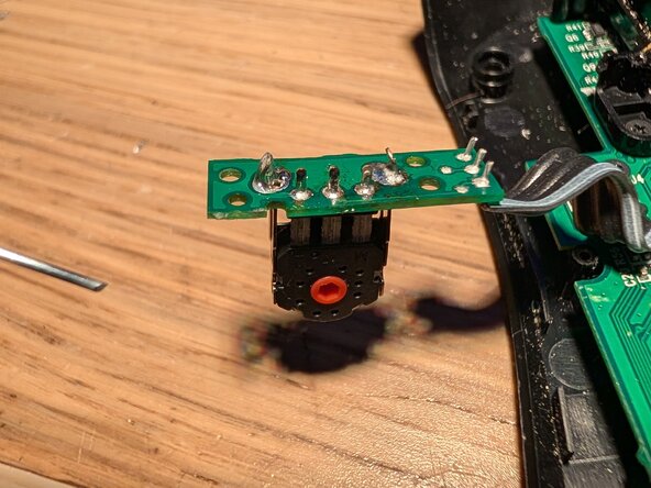

  5. Replacing the scroll wheel encoder on the Logitech G403 Wired, Remove sensor: step 5, image 1 of 2 Replacing the scroll wheel encoder on the Logitech G403 Wired, Remove sensor: step 5, image 2 of 2
    • First, remove the screws holding the rotary sensor in place. (Make sure to keep them separate from the previous screws)
    • Carefully move the scrollwheel and sensor assembly to the side.
    • Put the scroll wheel plastic to the side.

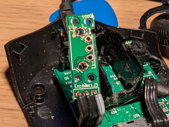

    • Now to remove the sensor, either:
    • Desolder using the soldering iron and solder sucker which takes some skill.
    • Or snip the legs of the encoder carefully, making sure not to damage the PCB. Then use the soldering iron and solder sucker to remove the remnants. (Much easier, i opted for this)
    • Be careful not to destroy the cable linking the PCB to the rest of the mouse.
  6. Replacing the scroll wheel encoder on the Logitech G403 Wired, Clean up and new sensor: step 6, image 1 of 3 Replacing the scroll wheel encoder on the Logitech G403 Wired, Clean up and new sensor: step 6, image 2 of 3 Replacing the scroll wheel encoder on the Logitech G403 Wired, Clean up and new sensor: step 6, image 3 of 3
    • After cleaning existing solder, install the new sensor.
    • Start by putting the sensor in place and soldering it one point.
    • This allows you to adjust the orientation of the sensor should it not be correct by reheating the solder joint and moving it in-place.
    • Solder the rest of the legs for the encoder.
    • I also recommend going through the insides of the mouse with a toothbrush at this point, making sure to get all the dust out from inside of it.

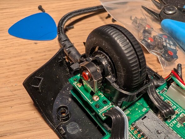

  7. Replacing the scroll wheel encoder on the Logitech G403 Wired: step 7, image 1 of 1
    • Put the encoder back into position and screw it into place, using the two smaller screws.
    • (Recommended) Test the mousewheel by plugging it into a computer, the scrolling should work both ways.
