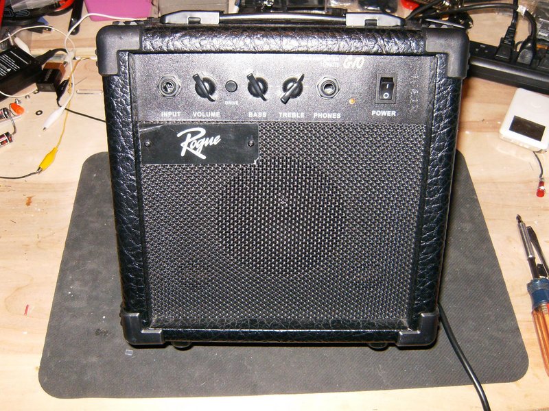

Here is an inexpensive Guitar Amplifier that came to me for a "rattling on the inside" and " no power" issue. I figured I can take a look at it and see what needs to be done. Straight forward disassembly made it easy and no service manual is needed. Trouble shooting consist of visual as well as some component testing.
    1. Repairing the audio amplifier, Repairing the audio amplifier: step 1, image 1 of 3 Repairing the audio amplifier, Repairing the audio amplifier: step 1, image 2 of 3 Repairing the audio amplifier, Repairing the audio amplifier: step 1, image 3 of 3
      • Here is the Amp in all its miniature glory. total size is 91/2 inches X 9 5/8inches and 6 inches deep. All controls are in the front panel.
