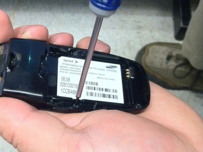

    1. Repairing Samsung SPH-A640 Keypad Replacement, Keypad: step 3, image 1 of 1
      • Using a #00 Phillips screwdriver, remove four screws from the bottom half of the phone in the battery compartment. Place screws off to the side.
