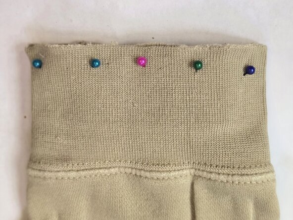

    3. Repair a Frayed Sweatshirt Cuff by Hand Sewing: step 3, image 1 of 3 Repair a Frayed Sweatshirt Cuff by Hand Sewing: step 3, image 2 of 3 Repair a Frayed Sweatshirt Cuff by Hand Sewing: step 3, image 3 of 3
      • Flip cuff inside out so it is easier to work with.
      • Push pins through both layers of fabric to hold them flat and steady while sewing.
      • It is easy to prick oneself when working with needles or pins. If thimbles are not available band-aids provide good protection and traction.
      • Once the pins have been placed, flip the cuff back to its normal position.

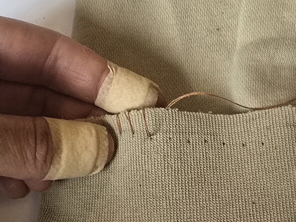

    7. Repair a Frayed Sweatshirt Cuff by Hand Sewing: step 7, image 1 of 2 Repair a Frayed Sweatshirt Cuff by Hand Sewing: step 7, image 2 of 2
      • Pull the thread snug after each stitch so it holds the cuff together.
      • Don't pull so tight that the fabric bunches up or puckers.
      • This stitch is called a whip stitch, it loops over the top edge of the cuff and back up through the fabric, like in the photo.
