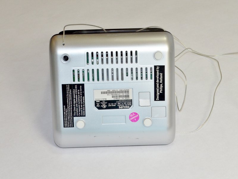

    1. Removing Philips DC320 37 Bottom Panel, Docking entertainment system: step 1, image 1 of 1
      • Pry off the four white feet with the pointed end of the spudger
