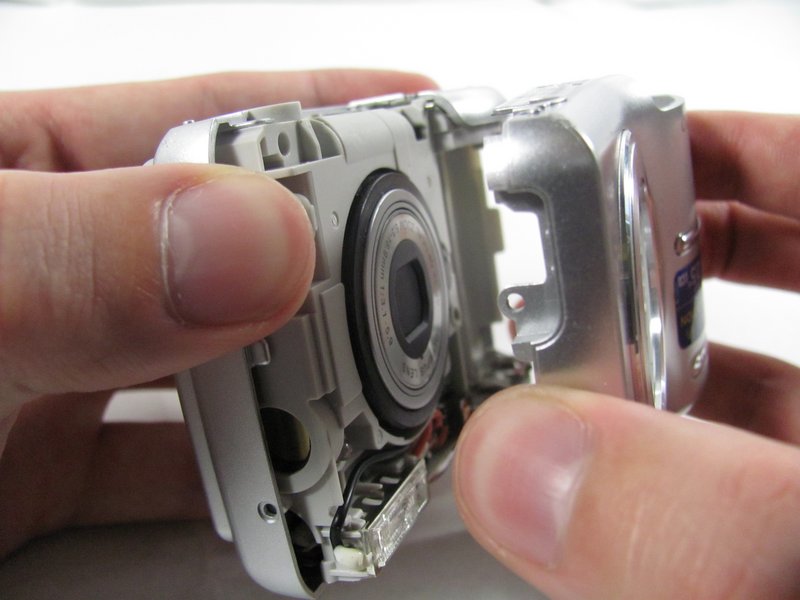

    1. Removing Olympus FE-210 Front Casing, Front Casing: step 3, image 1 of 3 Removing Olympus FE-210 Front Casing, Front Casing: step 3, image 2 of 3 Removing Olympus FE-210 Front Casing, Front Casing: step 3, image 3 of 3
      • Remove the seven screws holding the front case in place, with a Phillips #00 screwdriver.
      • Six screws are 3.6 mm.
      • The seventh screw is 3.2 mm.
      Ask FixBot
    2. Removing Olympus FE-210 Front Casing: step 4, image 1 of 3 Removing Olympus FE-210 Front Casing: step 4, image 2 of 3 Removing Olympus FE-210 Front Casing: step 4, image 3 of 3
      • Insert an opening tool or spudger into the seam between the front case and body of the camera to release the clips holding it together.
      • These three places are located:
      • At the top and bottom of the battery side (opposite of side pictured) of the case.
      • Right in the middle of the DC-in side (side pictured) of the case.
      • Top of the camera, to the left of the power button.
      • Once those places are disconnected, the front case will pop right off.
      • The camera in the first two pictures is upside down. This is the best position to place your thumbs to remove the case.
