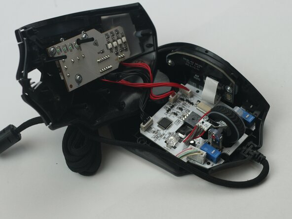

    1. Redragon Impact M908 Scroll Wheel Replacement, Scroll Wheel: step 4, image 1 of 3 Redragon Impact M908 Scroll Wheel Replacement, Scroll Wheel: step 4, image 2 of 3 Redragon Impact M908 Scroll Wheel Replacement, Scroll Wheel: step 4, image 3 of 3
      • Unscrew the right-hand 3mm screw using a Phillips #000 screwdriver.
      • Unscrew the remaining four 4mm screws using a Phillips #00 screwdriver.
      Ask FixBot
    2. Redragon Impact M908 Scroll Wheel Replacement: step 5, image 1 of 2 Redragon Impact M908 Scroll Wheel Replacement: step 5, image 2 of 2
      • Lift the mouse's top and remove it from the bottom.
      • Place the top to the side, out of the way.
      • The top does not need to be fully removed from the base, and it can be set aside with the connecting cables attached.
      Ask FixBot
    3. Redragon Impact M908 Scroll Wheel Replacement: step 6, image 1 of 3 Redragon Impact M908 Scroll Wheel Replacement: step 6, image 2 of 3 Redragon Impact M908 Scroll Wheel Replacement: step 6, image 3 of 3
      • Identify the scroll wheel in the center of the mouse.
      • Unscrew the 3.5mm screw holding the scroll wheel in place using a Phillips #00 screwdriver.
      Ask FixBot
    4. Redragon Impact M908 Scroll Wheel Replacement: step 7, image 1 of 2 Redragon Impact M908 Scroll Wheel Replacement: step 7, image 2 of 2
      • Lift the scroll wheel and pull it out of the mouse.
