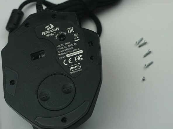

      • Make sure your mouse is unplugged from all devices.
      • Pick up your mouse and flip it over.
      • Reposition the mouse so that the four feet pads are facing you.
      Ask FixBot
    2. Redragon Impact M908 MMO Programmable Side Buttons Replacement: step 2, image 1 of 3 Redragon Impact M908 MMO Programmable Side Buttons Replacement: step 2, image 2 of 3 Redragon Impact M908 MMO Programmable Side Buttons Replacement: step 2, image 3 of 3
      • Place the pointed edge of a spudger under the corner of one of the feet pads.
      • Press the tool forward, lifting the foot pad until it is fully removed.
      Ask FixBot
    3. Redragon Impact M908 MMO Programmable Side Buttons Replacement: step 3, image 1 of 1
      • Repeat the process in step two for the other three feet pads.
      Ask FixBot
    1. Redragon Impact M908 MMO Programmable Side Buttons Replacement, MMO Programmable Side Buttons: step 4, image 1 of 3 Redragon Impact M908 MMO Programmable Side Buttons Replacement, MMO Programmable Side Buttons: step 4, image 2 of 3 Redragon Impact M908 MMO Programmable Side Buttons Replacement, MMO Programmable Side Buttons: step 4, image 3 of 3
      • Unscrew the right 3mm screw using a Phillips #000 screwdriver.
      • Unscrew the remaining four 4mm screws using a Phillips #00 screwdriver.

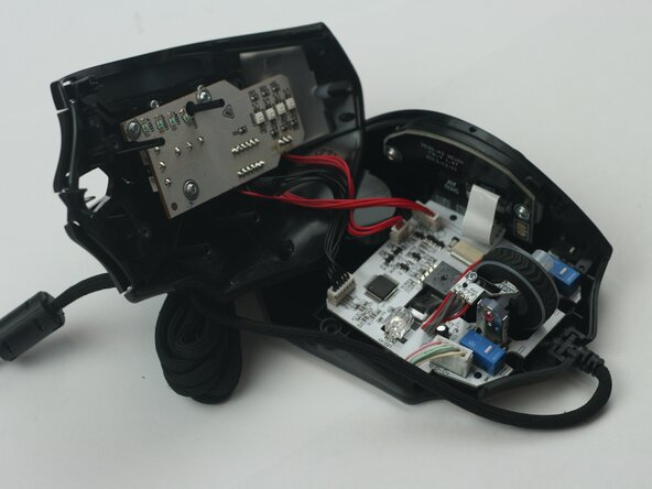

    2. Redragon Impact M908 MMO Programmable Side Buttons Replacement: step 5, image 1 of 2 Redragon Impact M908 MMO Programmable Side Buttons Replacement: step 5, image 2 of 2
      • Lift the mouse's top and remove it from the bottom.
      • Place the top to the side, out of the way.
      • The top does not need to be fully removed from the base, and it can be set aside with the connecting cables attached.
      Ask FixBot
    3. Redragon Impact M908 MMO Programmable Side Buttons Replacement: step 6, image 1 of 3 Redragon Impact M908 MMO Programmable Side Buttons Replacement: step 6, image 2 of 3 Redragon Impact M908 MMO Programmable Side Buttons Replacement: step 6, image 3 of 3
      • Identify the 12-button side panel inside the mouse on the left edge.
      • Unscrew both of the 3.5mm screws holding the 12-button side panel down using a Phillips #00 screwdriver.
      • Push the panel toward the inside of the mouse to remove it.
