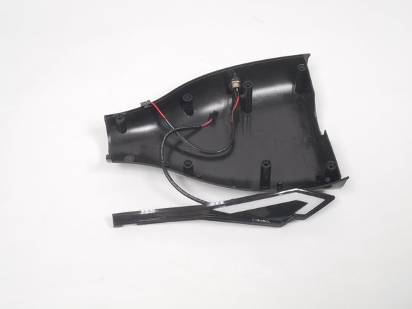

  9. Razor Hovertrax 2.0 Light Replacement: step 9, image 1 of 2 Razor Hovertrax 2.0 Light Replacement: step 9, image 2 of 2
    • Remove the four indicated screws using a Philips head screwdriver.
    • After removing all the screws lift the led light housing off the cover.
