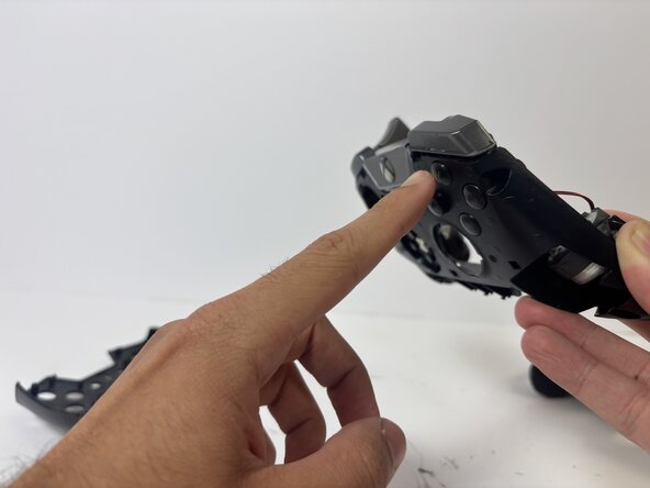

    5. Razer Wolverine Ultimate Face Buttons Replacement: step 9, image 1 of 1
      • Push the face buttons out from the front side of the controller.
      • Be advised as the buttons are not firmly in place; they can fall out.
      Ask FixBot
