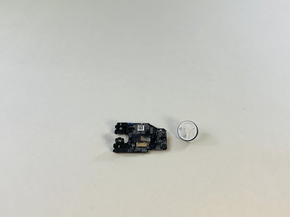

    4. Razer Orochi V2 Scroll Wheel Replacement: step 6, image 1 of 2 Razer Orochi V2 Scroll Wheel Replacement: step 6, image 2 of 2
      • Take out the circuit board.
      Ask FixBot
    1. Razer Orochi V2 Scroll Wheel Replacement, Scroll Wheel: step 7, image 1 of 2 Razer Orochi V2 Scroll Wheel Replacement, Scroll Wheel: step 7, image 2 of 2
      • Push the scroll wheel in lightly and release it.
