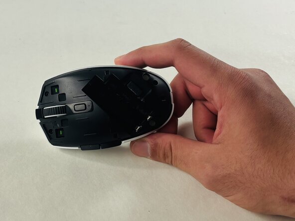

    1. Razer Orochi V2 Baseplate Replacement, Battery: step 1, image 1 of 3 Razer Orochi V2 Baseplate Replacement, Battery: step 1, image 2 of 3 Razer Orochi V2 Baseplate Replacement, Battery: step 1, image 3 of 3
      • Remove the top shell of the mouse.
      Ask FixBot
    2. Razer Orochi V2 Baseplate Replacement: step 2, image 1 of 1
      • Remove the old battery and replace it with a new battery.

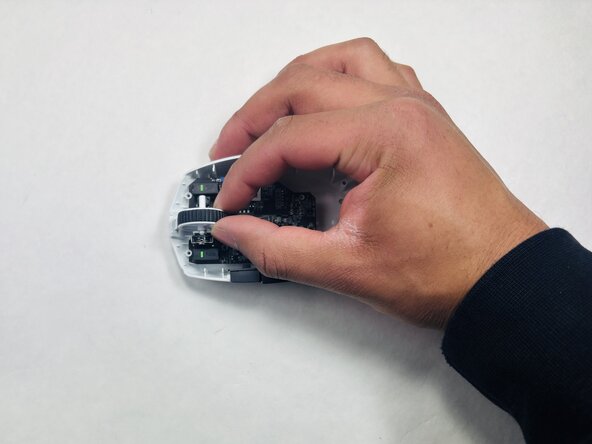

    2. Razer Orochi V2 Baseplate Replacement: step 4, image 1 of 3 Razer Orochi V2 Baseplate Replacement: step 4, image 2 of 3 Razer Orochi V2 Baseplate Replacement: step 4, image 3 of 3
      • Position the plastic opening tool above the side buttons and lift to remove the top cover.
      • Use caution when pulling off the top cover as the wires are still connected.
      • Disconnect the bundled cable connector, by pulling gripping all of the wires and gently pulling, rocking side to side until the connector comes out of the socket.
