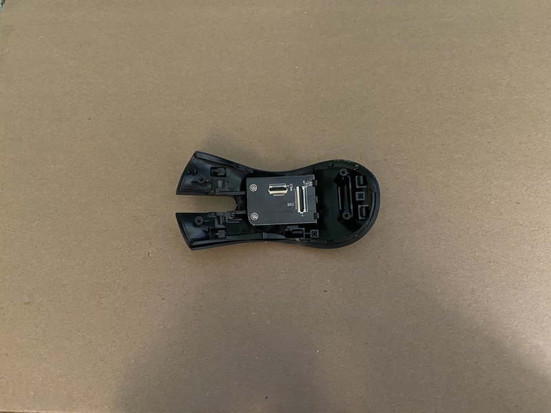

    1. Razer Naga Epic Top Panel Disassembly, Identify attachment points: step 1, image 1 of 2 Razer Naga Epic Top Panel Disassembly, Identify attachment points: step 1, image 2 of 2
      • The PCB is held to the top panel by...
      • 2 x 6mm Phillips #0 screws towards the front

    2. Razer Naga Epic Top Panel Disassembly, Unscrew the PCB: step 2, image 1 of 1
      • Unscrew the 2 screws holding the PCB into the top panel.

    3. Razer Naga Epic Top Panel Disassembly, Slide PCB away from the top panel: step 3, image 1 of 3 Razer Naga Epic Top Panel Disassembly, Slide PCB away from the top panel: step 3, image 2 of 3 Razer Naga Epic Top Panel Disassembly, Slide PCB away from the top panel: step 3, image 3 of 3
      • Carefully slide the PCB horizontally away from the grooves on the rear end of the top panel.
