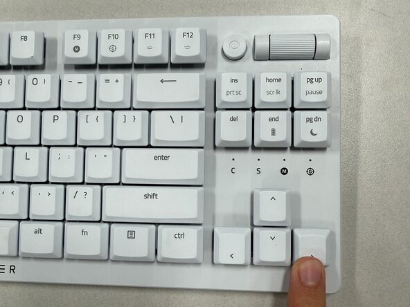

    1. Razer DeathStalker V2 Pro TKL Key Switch Replacement, Razer DeathStalker V2 Pro TKL Switch Replacement: step 1, image 1 of 3 Razer DeathStalker V2 Pro TKL Key Switch Replacement, Razer DeathStalker V2 Pro TKL Switch Replacement: step 1, image 2 of 3 Razer DeathStalker V2 Pro TKL Key Switch Replacement, Razer DeathStalker V2 Pro TKL Switch Replacement: step 1, image 3 of 3
      • Place two fingers on the top and the bottom of the key that needs to be replaced, gently grasp and lift the key.
      • Use a key cap puller if it's difficult to remove the keys by hand.

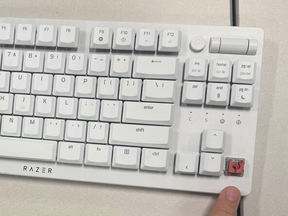

    2. Razer DeathStalker V2 Pro TKL Key Switch Replacement: step 2, image 1 of 2 Razer DeathStalker V2 Pro TKL Key Switch Replacement: step 2, image 2 of 2
      • Use a switch puller to remove the switch from the keyboard.
      • Press the puller over the switch until it clicks into place.
      • Gently lift upward to release the switch from the socket.
      • After removing the switch, check for dust and debris. Use a dust blower to clear loose dust, then gently clean beneath the switch with a microfiber cloth or cotton swab dampened with 90% or higher isopropyl alcohol before reinstalling it.
