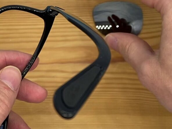

    1. Ray-Ban RB4264 Lens Replacement, Check the model and the lens size: step 1, image 1 of 1
      • Look at the inside of the temple arms. One of them carries a code such as RB4264 601/J0 58â–¡18.
      • RB4264 is the model, 601/J0 the colour, 58 the lens width in millimetres and 18 the bridge width.
      • If the print has worn off, compare the frame with the lens size: the RB4264 lens is 58 mm wide.
