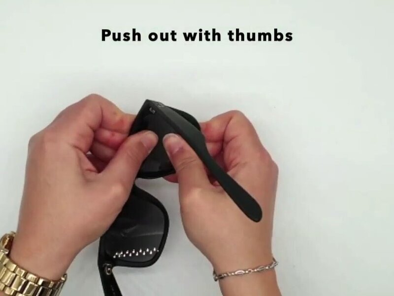

    1. Ray-Ban Justin RB4165 Lens Replacement, Push the old lens out: step 1, image 1 of 1
      • Open the temple arms and hold the frame with the inside (the side facing your eyes) towards you.
      • Place both thumbs near the centre of the lens, on the inside, and press gently outwards until the lens clicks out of the rim.
      • Push from the inside only. Do not lever the lens out with a screwdriver or a knife: it marks the frame and scratches the lens.
      • If you are replacing both lenses, do one side at a time. The lens still in the frame shows you the correct orientation.
