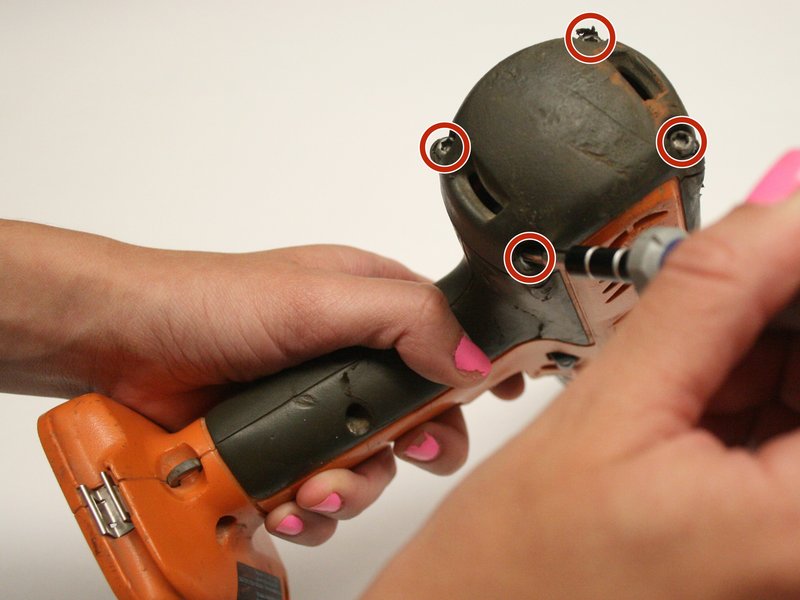

    1. RIDGID R84015 X2 Case Removal, RIDGID R84015 X2 Case Removal: step 1, image 1 of 2 RIDGID R84015 X2 Case Removal, RIDGID R84015 X2 Case Removal: step 1, image 2 of 2
      • Remove the backplate.
      • Using a Torx T20 screwdriver, remove the four screws attaching the back plate.
