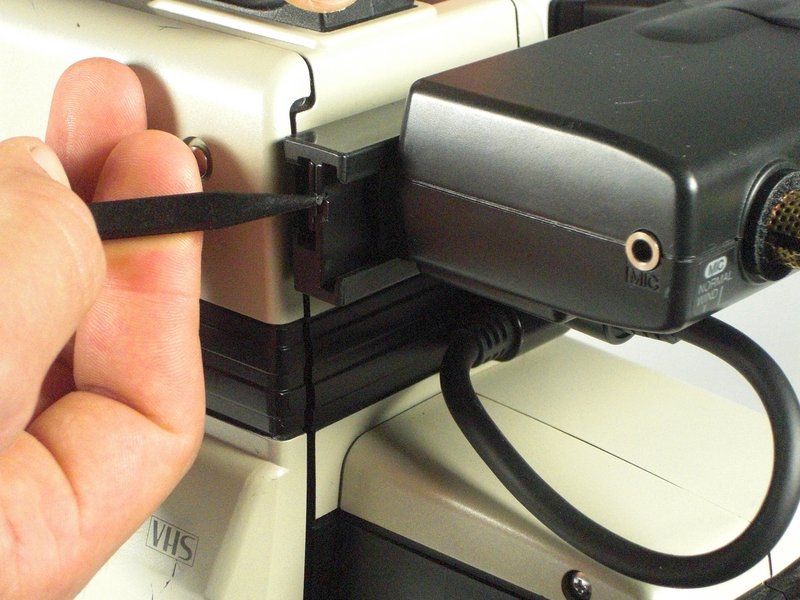

This guide will instruct on how to replace a malfunctioning Viewfinder assembly on the RCA CC310.

    1. RCA CC310 Viewfinder Replacement, Viewfinder: step 1, image 1 of 2 RCA CC310 Viewfinder Replacement, Viewfinder: step 1, image 2 of 2
      • Slide a spudger between the plastic rail and the metal tab on the left side of the rail. Push away from the camcorder to release the flap.
      • Pushing the viewfinder assembly to the right makes lifting the flap easier.
      • Slide the lifted flap towards the viewfinder assembly until the viewfinder is free from the rail.
