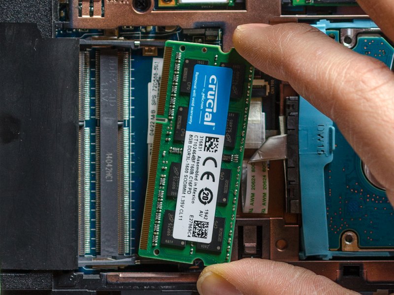

    4. RAM memory upgrade / replacement, Mount one of the new modules inside the bottom slot: step 8, image 1 of 3 RAM memory upgrade / replacement, Mount one of the new modules inside the bottom slot: step 8, image 2 of 3 RAM memory upgrade / replacement, Mount one of the new modules inside the bottom slot: step 8, image 3 of 3
      • Are you grounded? If yes, take one of the new memory modules and align it with the connector by the correct side: the close-to-the-middle indentation of the module has to face the highlighted pin.
      • Then, keeping it tilted and carrying on the "pendulum" movement, gently push the module inside the slot. STOP when you feel you can't go any further: the new memory module should be now tilted and totally inside the connector - as it is shown in pic#2 - and the indentation of the module should almost be attached to the centring pin.
      • Once that the module is so positioned, gently press it down pushing it in the middle with your fingers until you hear a loud click: that sound means that the retaining arms have correctly grabbed the module and that the latter one has been successfully inserted!
      Ask FixBot
    5. RAM memory upgrade / replacement, Mount the second module on top of the previous one: step 9, image 1 of 3 RAM memory upgrade / replacement, Mount the second module on top of the previous one: step 9, image 2 of 3 RAM memory upgrade / replacement, Mount the second module on top of the previous one: step 9, image 3 of 3
      • Repeat the same process in order to insert the remaining module and it's done!
      Ask FixBot
You have successfully replaced the RAM memory! Congratulations :) Now remove the tape and reassemble the service door and the battery. Enjoy the new piece of hardware, cheers!
