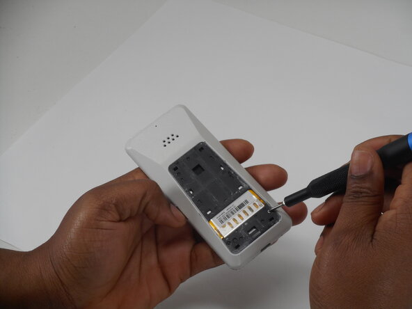

    3. Punkt MP02 Battery Replacement: step 3, image 1 of 3 Punkt MP02 Battery Replacement: step 3, image 2 of 3 Punkt MP02 Battery Replacement: step 3, image 3 of 3
      • Use a Phillips screwdriver to remove the two adjacent 3 mm Phillips screws.

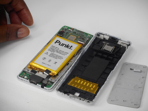

    4. Punkt MP02 Battery Replacement: step 4, image 1 of 3 Punkt MP02 Battery Replacement: step 4, image 2 of 3 Punkt MP02 Battery Replacement: step 4, image 3 of 3
      • Insert a Jimmy into the seam between the front and back case.
      • Slide the Jimmy around the perimeter while prying to separate the front and back case.
      Ask FixBot

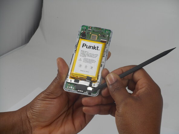

    5. Punkt MP02 Battery Replacement: step 5, image 1 of 2 Punkt MP02 Battery Replacement: step 5, image 2 of 2
      • Use a spudger to pry up and disconnect the battery press connector.
      • Make sure to pry under the connector itself and not on the board.
      Ask FixBot
    6. Punkt MP02 Battery Replacement: step 6, image 1 of 2 Punkt MP02 Battery Replacement: step 6, image 2 of 2
      • Gently pry the battery off with the spudger tool.
      • Take care not to bend, warp, or puncture the battery during removal.
