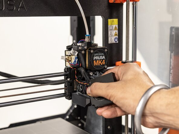

    1. Prusa MK4 Print Fan Replacement, Print Fan: step 1, image 1 of 3 Prusa MK4 Print Fan Replacement, Print Fan: step 1, image 2 of 3 Prusa MK4 Print Fan Replacement, Print Fan: step 1, image 3 of 3
      • Make sure the printer is turned off and the power cord is unplugged before you begin.
      • Move the extruder to the middle of the X and Y axes to ensure the workspace is clear.
      • Remove the Loveboard cover from the toolhead and set it aside.

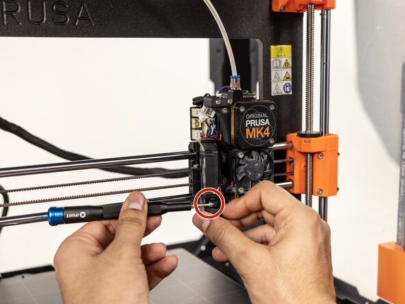

    3. Prusa MK4 Print Fan Replacement: step 3, image 1 of 2 Prusa MK4 Print Fan Replacement: step 3, image 2 of 2
      • Use a 2.4mm hex key to unscrew the fasteners holding the print fan to the side of the extruder.

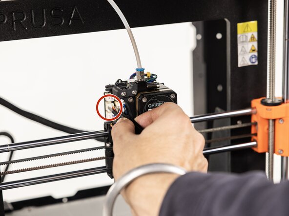

    7. Prusa MK4 Print Fan Replacement: step 7, image 1 of 3 Prusa MK4 Print Fan Replacement: step 7, image 2 of 3 Prusa MK4 Print Fan Replacement: step 7, image 3 of 3
      • Gently snap the new cooling fan's connector into its dedicated port on the Loveboard.
