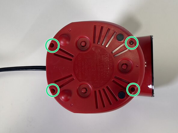

    2. Presto Hot Air Popcorn Popper Disassembly: step 2, image 1 of 2 Presto Hot Air Popcorn Popper Disassembly: step 2, image 2 of 2
      • Remove the four 14.2mm screws on the bottom of the popper with a Phillips #1 screwdriver.
      • It may be useful to use a screwdriver with a longer, magnetic head to remove the deeper-set screws entirely.

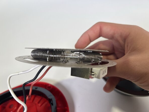

    5. Presto Hot Air Popcorn Popper Disassembly: step 5, image 1 of 3 Presto Hot Air Popcorn Popper Disassembly: step 5, image 2 of 3 Presto Hot Air Popcorn Popper Disassembly: step 5, image 3 of 3
      • Take the upper red motor portion off the main assembly. There will be wires connecting the two.
      • Remove the metallic heater, hot plate, and black spacer. Wires will attach to the metallic heating element.
