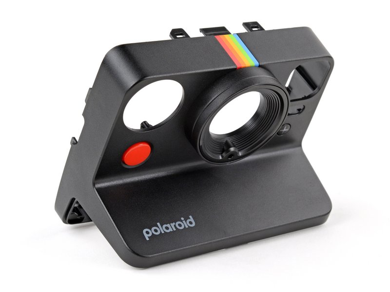

    2. Polaroid Now Gen 3 Front Shell Replacement, Remove the front shell screws: step 23, image 1 of 3 Polaroid Now Gen 3 Front Shell Replacement, Remove the front shell screws: step 23, image 2 of 3 Polaroid Now Gen 3 Front Shell Replacement, Remove the front shell screws: step 23, image 3 of 3
      Tool used on this step:
      Phillips #00 Screwdriver
      $5.49
      Buy
      • Use a Phillips screwdriver to remove the three screws securing the front shell:
      • Two 5.9 mm‑long screws hidden in recesses on the left and right sides (one near the battery recess and one with a cutout in the main board)
      • You may need a flashlight to see the screws, as well as a skinny, long‑shank screwdriver to reach the one with a cutout in the main board.
      • One 5.4 mm‑long screw on the top edge of the main board
      Ask FixBot
    3. Polaroid Now Gen 3 Front Shell Replacement, Remove the front shell: step 24, image 1 of 3 Polaroid Now Gen 3 Front Shell Replacement, Remove the front shell: step 24, image 2 of 3 Polaroid Now Gen 3 Front Shell Replacement, Remove the front shell: step 24, image 3 of 3
      • Plastic clips loosely secure the top and bottom edges of the front shell.
      • With the right side of the camera facing up, hold the main body of your camera in one hand and the front shell in the other.
      • Holding the camera with the right side up helps prevent the white plastic gear from falling out when removing the shell.
      • Gently squeeze the sides of the front shell to release the clips and pull the shell off the main body of the camera.
      Ask FixBot
