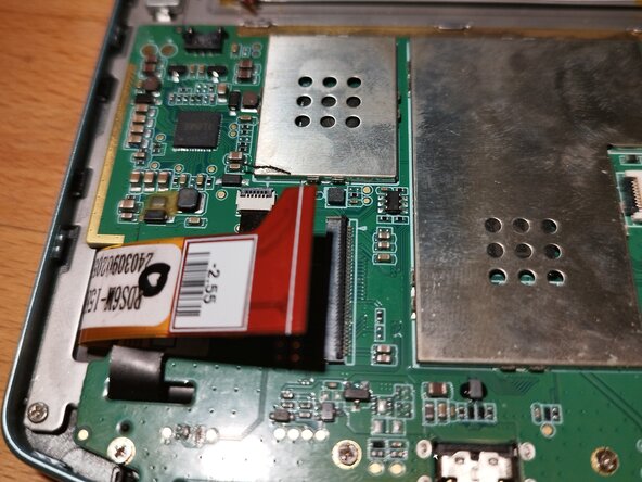

    5. PocketBook Verse PB629 Screen Replacement, Remove back lighting connector: step 5, image 1 of 3 PocketBook Verse PB629 Screen Replacement, Remove back lighting connector: step 5, image 2 of 3 PocketBook Verse PB629 Screen Replacement, Remove back lighting connector: step 5, image 3 of 3
      • Flip up the black switch.
      • Pull out the flexcable.

    12. PocketBook Verse PB629 Screen Replacement, Replacement parts: step 12, image 1 of 1
      • Search for replacement parts with following properties:
      • Suitable for Pocketbook verse PB692
      • Screen ED060XCG,ED060XCH or similar
      • Three flexcables!!! (only two and the touch or the backlight will not work)
      • The small flexcable on the right, for touchscreen has to read FT6336U as other protocols will also not work.
