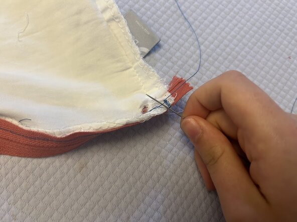

    5. Pillowcase Zipper Replacement: step 5, image 1 of 3 Pillowcase Zipper Replacement: step 5, image 2 of 3 Pillowcase Zipper Replacement: step 5, image 3 of 3
      • Cut a thread that is about three times the length of the pillowcase opening.
      • You can use a shorter thread, but you may have to tie a knot and repeat the process in smaller sections.
      • Tie a triple knot at one end of the thread.
      • At the other end, thread the eye of a needle and hold both ends in the same direction.
      Ask FixBot
    6. Pillowcase Zipper Replacement: step 6, image 1 of 3 Pillowcase Zipper Replacement: step 6, image 2 of 3 Pillowcase Zipper Replacement: step 6, image 3 of 3
      • The needle is sharp. Be cautious when poking it through the fabric to prevent pricking your finger.
      • Insert the needle from the back of the pillowcase, halfway between the zipper teeth and the edge of the zipper fabric. Pull the thread all the way through until the knot catches the fabric.
      • Move a half inch to the right and insert the needle from front to back. This is how you start the backstitch.
      • Move another half inch to the right, and insert the needle from the back to the front and pull all the way through.
      • Poke the needle back through the same hole that was created when you first pulled the needle from front to back. Make sure that the needle is going through the same hole in both layers of fabric.
      • From the back, move the needle one inch to the right, and pull the thread all the way through. Repeat this process of moving one half inch to the left, pulling front to back, moving one inch to the right, then pulling back to front.
