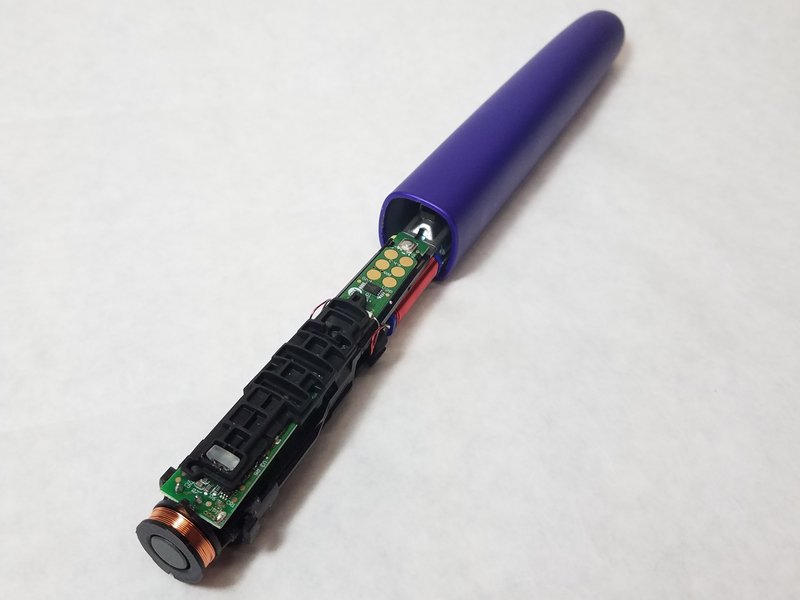

This guide will show you how to remove the outer case from your (9300 Series) Philips Sonicare DiamondClean toothbrush. This case protects the internal parts from water and toothbrushing products. If you notice the buttons are not working properly or if the toothbrush is not charging as well as it used to, residue buildup may be the problem. Replacing the outer case will help your toothbrush to maintain proper contact with the charging base and will allow the buttons to function normally again.

    4. Philips Sonicare DiamondClean Case Replacement: step 4, image 1 of 2 Philips Sonicare DiamondClean Case Replacement: step 4, image 2 of 2
      • Put the metal head on a solid surface with handle perpendicular to the surface. Firmly, yet gently, push down until the internals start to slide out.
