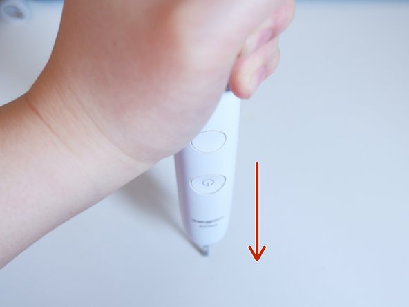

  3. Philips Sonicare 9350 Battery Replacement: step 3, image 1 of 3 Philips Sonicare 9350 Battery Replacement: step 3, image 2 of 3 Philips Sonicare 9350 Battery Replacement: step 3, image 3 of 3
    • Use a spudger to open the two clasps inside the toothbrush handle in a downward motion.
    • Turn the toothbrush upside down and push down on a hard surface—this will slide the toothbrush's internal body out.

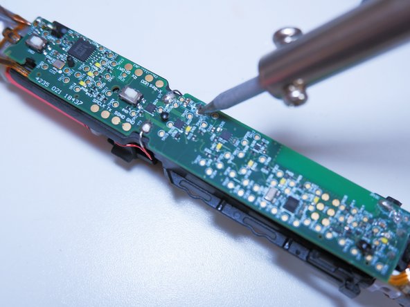

  6. Philips Sonicare 9350 Battery Replacement, Desolder both terminals: step 6, image 1 of 3 Philips Sonicare 9350 Battery Replacement, Desolder both terminals: step 6, image 2 of 3 Philips Sonicare 9350 Battery Replacement, Desolder both terminals: step 6, image 3 of 3
    • Open the protection cover of the circuit board.
    • Find the welding points of the positive and negative electrodes of the battery and use the soldering iron to desolder.
    • The battery will fall off after desoldering as shown in the figure.
    • Be careful not to touch other parts of the circuit board when desoldering.
