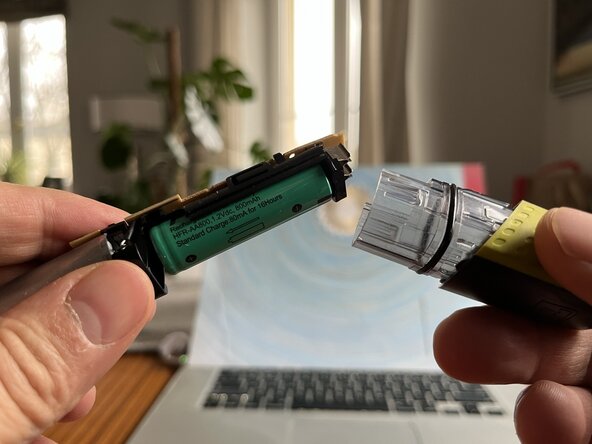

  1. Philips Norelco OneBlade Battery Replacement, Disassembling the case: step 1, image 1 of 3 Philips Norelco OneBlade Battery Replacement, Disassembling the case: step 1, image 2 of 3 Philips Norelco OneBlade Battery Replacement, Disassembling the case: step 1, image 3 of 3
    • This is the most difficult part of the process. Both parts of the shaver are press-fit together, and separating them requires a fair amount of force and patience. Grip both ends of the device and, while gently twisting them against each other, try to pull them apart. I recommend using gloves with a rubberized grip.

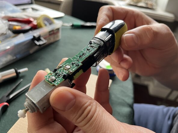

  2. Philips Norelco OneBlade Battery Replacement, Desoldering engine connectors: step 2, image 1 of 3 Philips Norelco OneBlade Battery Replacement, Desoldering engine connectors: step 2, image 2 of 3 Philips Norelco OneBlade Battery Replacement, Desoldering engine connectors: step 2, image 3 of 3
    • Desolder the wires connecting the main board to the motor. Remember that the red wire is positive and the black wire is negative — you will need this when reassembling.
