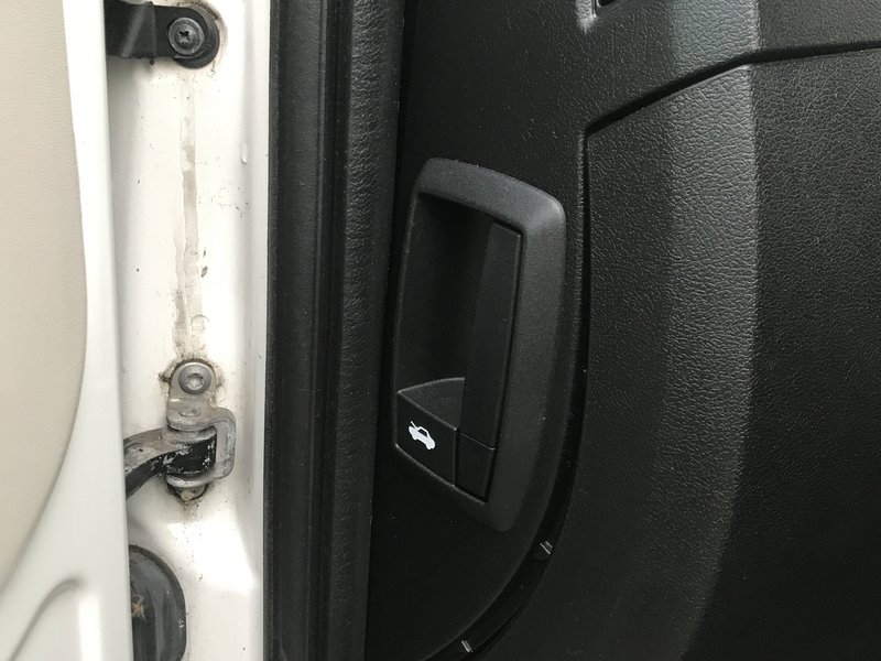

    1. Peugeot Boxer Headlamp Bulb Replacement, Bonnet Catch: step 1, image 1 of 1
      • Open the passenger side door to find the bonnet release catch.
      • Pull the catch down and towards you to release the bonnet of the van.
