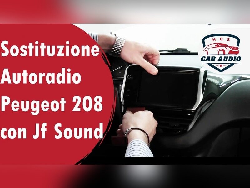

Use this guide to replace the original Peugeot 208 radio and small factory display with a JF Sound Android radio, such as the xDAB-style unit shown for this dashboard. This replacement can add a larger screen, Android functions, DSP audio controls, USB inputs, Bluetooth music, retained steering wheel controls, vehicle settings, and an optional rearview camera. Trim and connector details can vary by model year and equipment, so work slowly and compare each connector before plugging it in.
      • Turn off the ignition, set the parking brake, remove the key, and wait for the infotainment screen to shut down.
      • Use a wrench to disconnect the negative battery terminal before unplugging dashboard connectors.
      • Keep metal tools away from live connectors to avoid shorts and fault codes.
      • Protect the gloss-painted dashboard trim and the LCD screen from scratches while you work.
      • Use the visible landmarks in the dash: the upper trim, the original monitor, the radio support, and the original radio.
