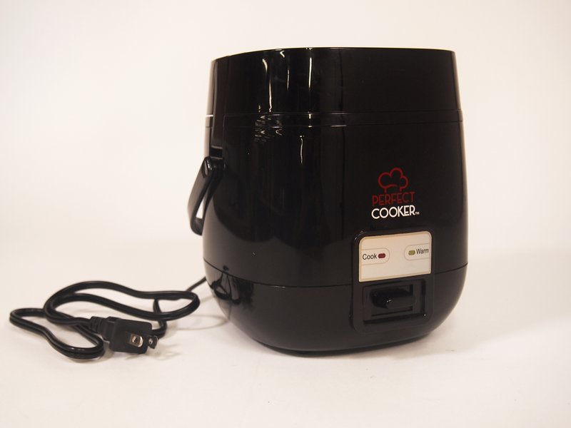

This is the Perfect Cooker RC301M. In this guide, we will be disassembling this rice cooker to gain a better idea of how this device works and for optimal cleaning.

    1. Perfect Cooker RC301M Disassembly, Perfect Cooker RC301M Disassembly: step 1, image 1 of 2 Perfect Cooker RC301M Disassembly, Perfect Cooker RC301M Disassembly: step 1, image 2 of 2
      • Remove the power cord and find a clean flat surface to work at.
      Ask FixBot
    2. Perfect Cooker RC301M Disassembly: step 2, image 1 of 3 Perfect Cooker RC301M Disassembly: step 2, image 2 of 3 Perfect Cooker RC301M Disassembly: step 2, image 3 of 3
      • Remove the lid by unhinging the side tabs.
      • Remove the inner pot and any other contents.
      Ask FixBot
    3. Perfect Cooker RC301M Disassembly: step 3, image 1 of 3 Perfect Cooker RC301M Disassembly: step 3, image 2 of 3 Perfect Cooker RC301M Disassembly: step 3, image 3 of 3
      • Flip the device over and look for the two screws recessed underneath the device.
      Ask FixBot
    4. Perfect Cooker RC301M Disassembly: step 4, image 1 of 3 Perfect Cooker RC301M Disassembly: step 4, image 2 of 3 Perfect Cooker RC301M Disassembly: step 4, image 3 of 3
      • Using a Phillips #2 screwdriver, remove the two 32.8 mm screws.
      Ask FixBot
    5. Perfect Cooker RC301M Disassembly: step 5, image 1 of 1
      • Carefully lift up the bottom to reveal the wires and mechanism.
      • Make sure not to pull it up too much as it is still connected to the device body with the center metal mechanism.
      Ask FixBot
    6. Perfect Cooker RC301M Disassembly: step 6, image 1 of 1
      • The center mechanism is directly in the center of the device and connects the switch to the middle
      • This part of the device raises and lowers the burner to change from the cook to warm function.
      • The two parts of the mechanism are connected by a simple metal “T-shaped” tab.
      Ask FixBot
    7. Perfect Cooker RC301M Disassembly: step 7, image 1 of 3 Perfect Cooker RC301M Disassembly: step 7, image 2 of 3 Perfect Cooker RC301M Disassembly: step 7, image 3 of 3
      • Disconnect the two metal arms.
      • It can be seen that the metal tab must be bent into a “U-shape” in order to fit through the other arm of the mechanism.
      • Take the small chain nose pliers and bend each side of the “T-shaped” tab inwards.
      • Use trial and error to bend the tabs until they are able to fit through the “U-shape” cut out in the other arm.
      Ask FixBot
    8. Perfect Cooker RC301M Disassembly: step 8, image 1 of 2 Perfect Cooker RC301M Disassembly: step 8, image 2 of 2
      • Separate the two parts of the devices.
      • The "U-shape" cut out can now be clearly seen.
      • The T-tab remains in the "U-shape" after slipping through the slot.
      Ask FixBot
