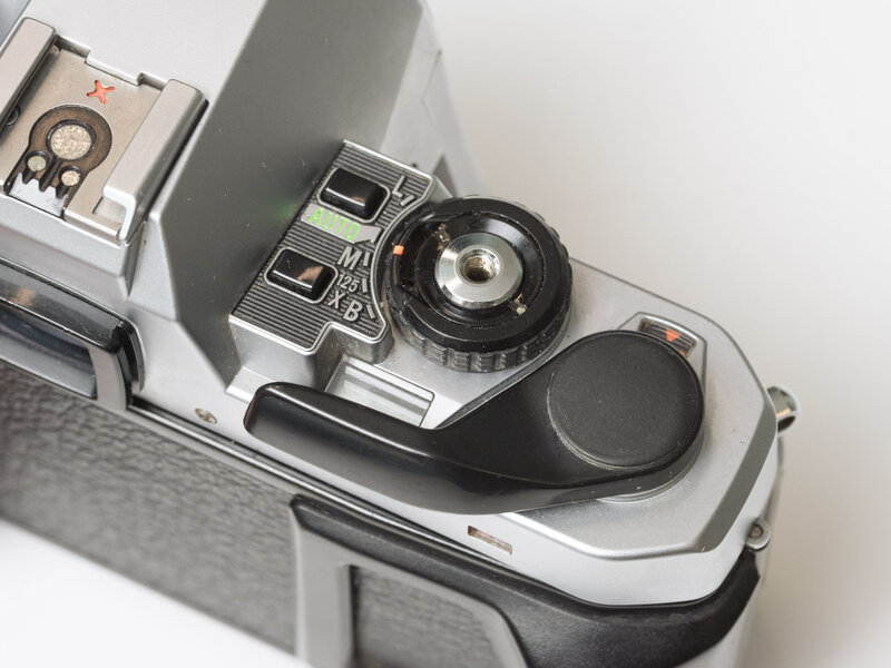

    1. Pentax Super Program Top Cover Removal, Remove film advance lever: step 1, image 1 of 3 Pentax Super Program Top Cover Removal, Remove film advance lever: step 1, image 2 of 3 Pentax Super Program Top Cover Removal, Remove film advance lever: step 1, image 3 of 3
      • Remove the rubber decorative cap. It is attached with contact cement underneath. Isopropyl Alcohol may be used to soften the adhesive.
      • Unscrew the lock nut using a spanner wrench. The lock nut is reverse threaded.
      • Lift off the advance lever.
      • Remove the spring washer.
      • Remove one shim washer.
