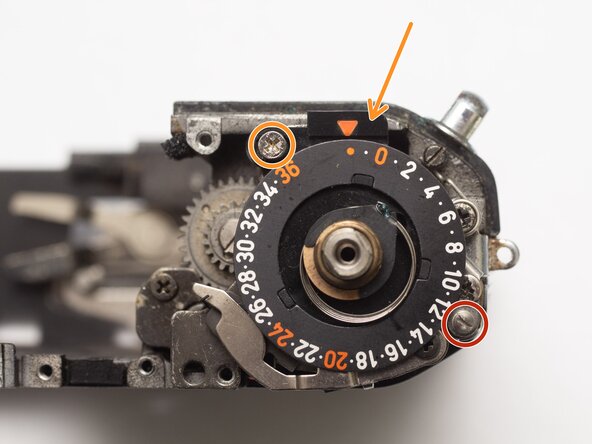

    1. Pentax Super Program Film Advance Mechanism Disassembly, Remove frame counter assembly: step 18, image 1 of 3 Pentax Super Program Film Advance Mechanism Disassembly, Remove frame counter assembly: step 18, image 2 of 3 Pentax Super Program Film Advance Mechanism Disassembly, Remove frame counter assembly: step 18, image 3 of 3
      • Remove one slotted screw.
      • Remove one screw and the frame number indicator.
      • Installation Notes: Position the advance cam as indicated before installing the counter assembly. After installation, make sure to hook the spring near the right side strap lug.
      Ask FixBot
