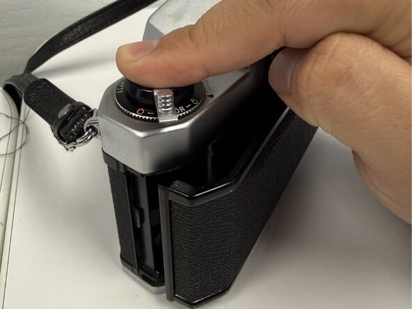

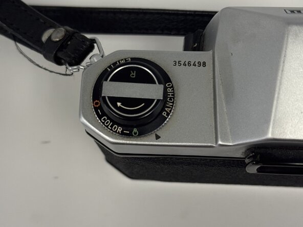

  2. Pentax Spotmatic Light Seals Replacement: step 2, image 1 of 3 Pentax Spotmatic Light Seals Replacement: step 2, image 2 of 3 Pentax Spotmatic Light Seals Replacement: step 2, image 3 of 3
    • Pull up the film rewind crank.
    • If the piece doesn't go up, you are most likely pulling up on the wrong side. Try flipping the other side.
    • The lever on the dial should be fully flipped.

  3. Pentax Spotmatic Light Seals Replacement: step 3, image 1 of 3 Pentax Spotmatic Light Seals Replacement: step 3, image 2 of 3 Pentax Spotmatic Light Seals Replacement: step 3, image 3 of 3
    • Holding onto the film rewind crank, pull up while holding down on the back part of the camera.
    • Let go then the back of the camera should open up.
    • Some resistance will be felt; pull until a click is heard.

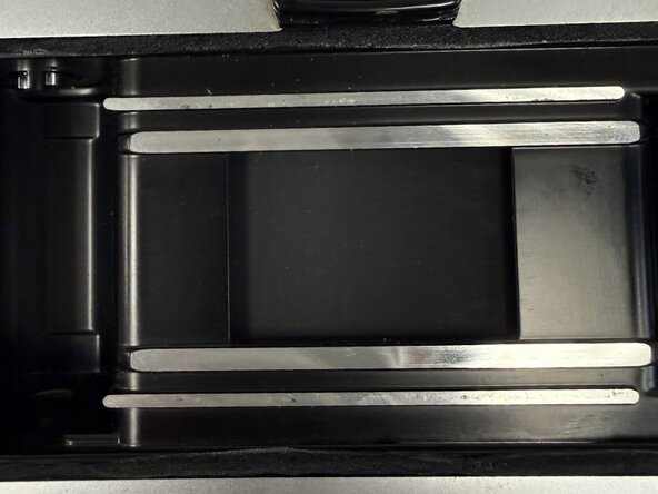

  4. Pentax Spotmatic Light Seals Replacement: step 4, image 1 of 3 Pentax Spotmatic Light Seals Replacement: step 4, image 2 of 3 Pentax Spotmatic Light Seals Replacement: step 4, image 3 of 3
    • Fully open the back section of the camera.
    • Lay the camera down.
    • Using any available paper, cut it to a size that will cover the area in the center.
    • This is done to prevent debris from landing on one of the camera's major parts.
    • Lay the paper over the midsection, ensuring the screen-like part is covered.

  5. Pentax Spotmatic Light Seals Replacement: step 5, image 1 of 3 Pentax Spotmatic Light Seals Replacement: step 5, image 2 of 3 Pentax Spotmatic Light Seals Replacement: step 5, image 3 of 3
    • Grab a toothpick and move to the lower part of the camera. This lower part contains the space where the old light seal is stored.
    • Hold the paper down with one hand. With the other hand, place a toothpick into the lower crevice and, while applying light force with the toothpick, move it to the opposite end, which will result in the breaking down and removal of the old light seal.
    • If one swipe of the toothpick does not remove all the light seal waste, repeat the light seal removal process until it is removed.
    • In the top portion, a small hole is present; make sure to avoid getting any debris in it.
