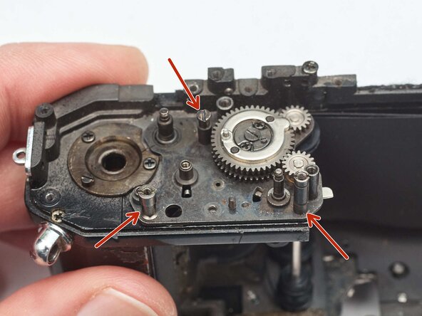

    8. Pentax MX Shutter Assembly Removal, Remove mirror box: step 16, image 1 of 3 Pentax MX Shutter Assembly Removal, Remove mirror box: step 16, image 2 of 3 Pentax MX Shutter Assembly Removal, Remove mirror box: step 16, image 3 of 3
      • Remove two M1.7 x 4.6 mm screws.
      • Remove two slotted posts.
      • It is possible to remove the mirror box without removing the posts, since the holes can slip over the top, but the process will be easier without them in place.
      • Lift the mirror box up and tilt the top forward to remove it.

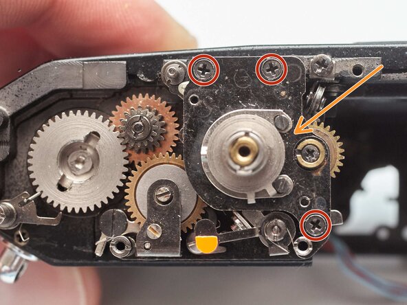

    3. Pentax MX Shutter Assembly Removal, Remove shutter dial assembly: step 22, image 1 of 3 Pentax MX Shutter Assembly Removal, Remove shutter dial assembly: step 22, image 2 of 3 Pentax MX Shutter Assembly Removal, Remove shutter dial assembly: step 22, image 3 of 3
      • Remove three screws.
      • Remove speed selector plate
      • Lift off high speed cam.
      • Remove spacer washer.
      Ask FixBot

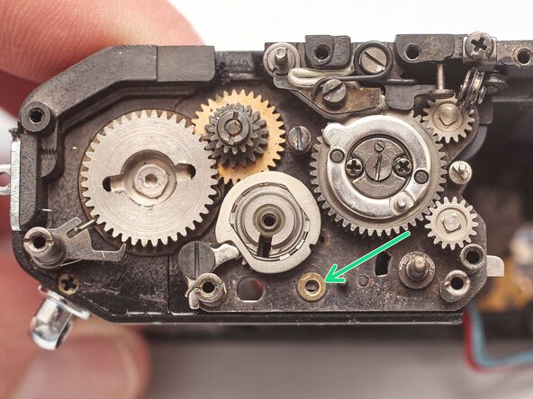

    7. Pentax MX Shutter Assembly Removal, Remove closing curtain latch: step 26, image 1 of 2 Pentax MX Shutter Assembly Removal, Remove closing curtain latch: step 26, image 2 of 2
      • Remove one M1.4 slotted nut.
      • Push the latch out from between the wind gears and slide it off the shaft.
      • Installation Notes: Note the position of the bias springs during installation.

    8. Pentax MX Shutter Assembly Removal, Remove upper transport gear: step 27, image 1 of 2 Pentax MX Shutter Assembly Removal, Remove upper transport gear: step 27, image 2 of 2
      • Remove one slotted post.
      • Remove plate.
      • Remove upper transport gear latch.
      • Remove upper transport gear.

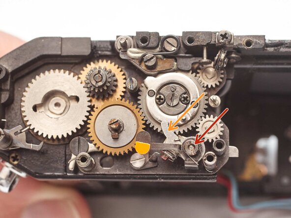

    10. Pentax MX Shutter Assembly Removal, Remove lower transport gear latch: step 29, image 1 of 2 Pentax MX Shutter Assembly Removal, Remove lower transport gear latch: step 29, image 2 of 2
      • Unhook bias spring.
      • Remove one M1.4 x 2.8 mm shoulder screw.
      • Remove lower transport gear latch and bias spring.
      • Remove washer.
      Ask FixBot

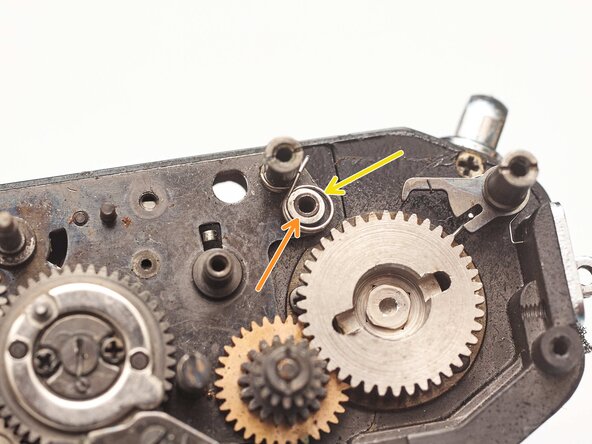

    12. Pentax MX Shutter Assembly Removal, Remove reverse stop: step 31, image 1 of 2 Pentax MX Shutter Assembly Removal, Remove reverse stop: step 31, image 2 of 2
      • Remove one M1.4 x 2.4 mm screw.
      • Remove washer.
      • Remove bias spring.
      Ask FixBot

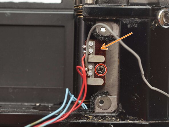

    4. Pentax MX Shutter Assembly Removal, Detach the flash sync PCB: step 36, image 1 of 1
      • Remove one screw.
      • Lift away the flash sync PCB. It is still connected by the red wires.
      Ask FixBot

    6. Pentax MX Shutter Assembly Removal, Remove main meter switch: step 38, image 1 of 1
      • Use isopropyl alcohol to soften the adhesive holding the wires.
      • Remove two screws.
      • Lift off the main meter switch and gently pull the blue wires through the hole in the chassis.

    7. Pentax MX Shutter Assembly Removal, Remove slow speed coupling rod: step 39, image 1 of 2 Pentax MX Shutter Assembly Removal, Remove slow speed coupling rod: step 39, image 2 of 2
      • Remove one circlip.
      • Remove the slow speed coupling rod through the bottom of the chassis.
      • To get the cam stack past the governor plate, first release the shutter. Then rotate the governor plate counter-clockwise. That should provide enough clearance to remove the slow speed coupling rod.
      Ask FixBot
    8. Pentax MX Shutter Assembly Removal, Remove loose washers: step 40, image 1 of 2 Pentax MX Shutter Assembly Removal, Remove loose washers: step 40, image 2 of 2
      • Remove one bushing.
      • Remove one shim washer.
      Ask FixBot
    9. Pentax MX Shutter Assembly Removal, Remove closing curtain delay gear: step 41, image 1 of 1
      • Remove one screw.
      • Lift off closing curtain delay gear.
      Ask FixBot
    10. Pentax MX Shutter Assembly Removal, Installation Notes: Closing Curtain Delay Gear: step 42, image 1 of 3 Pentax MX Shutter Assembly Removal, Installation Notes: Closing Curtain Delay Gear: step 42, image 2 of 3 Pentax MX Shutter Assembly Removal, Installation Notes: Closing Curtain Delay Gear: step 42, image 3 of 3
      • Clean the gear shaft and lubricate with shutter oil.
      • Charge the shutter. Manually push the opening curtain latch forward once the shutter is wound to hold it in position.
      • Temporarily install the slow speed governor.
      • Install the closing curtain delay gear such that the gap between the two governor plates is parallel.
      • Remove the slow speed governor.
      • Check that the stud on the bottom of the gear properly actuates the mirror release lever when the shutter is fired.
      Ask FixBot
    11. Pentax MX Shutter Assembly Removal, Remove closing curtain pinion gear: step 43, image 1 of 1
      • Remove one slotted screw.
      • Lift off closing curtain pinion gear.
      Ask FixBot
    12. Pentax MX Shutter Assembly Removal, Remove shutter curtain baffle: step 44, image 1 of 2 Pentax MX Shutter Assembly Removal, Remove shutter curtain baffle: step 44, image 2 of 2
      • Remove shutter curtain baffle.
      Ask FixBot

    19. Pentax MX Shutter Assembly Removal, Remove wind gear plate: step 51, image 1 of 2 Pentax MX Shutter Assembly Removal, Remove wind gear plate: step 51, image 2 of 2
      • Remove three slotted posts.
      • Lift the wind gear plate upward and out of the chassis.
      • The curtains and curtain pinions are attached to the plate and will come away with it.
      Ask FixBot
