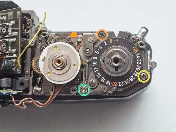

    1. Pentax MX Frame Counter Disassembly, Remove frame counter assembly: step 5, image 1 of 3 Pentax MX Frame Counter Disassembly, Remove frame counter assembly: step 5, image 2 of 3 Pentax MX Frame Counter Disassembly, Remove frame counter assembly: step 5, image 3 of 3
      • Temporarily replace the wind lever and move it into the stowed position.
      • Remove one M1.7 x 2.4 mm countersunk screw.
      • Remove one M1.7 x 3.8 mm screw.
      • Remove one M1.4 slotted nut.
      • Lift off frame counter mechanism.
      Ask FixBot
    2. Pentax MX Frame Counter Disassembly, Installation Notes: Frame Count Assembly: step 6, image 1 of 2 Pentax MX Frame Counter Disassembly, Installation Notes: Frame Count Assembly: step 6, image 2 of 2
      • Align the post on the ratcheting gear with the slot in the top wind gear.
      • The frame counter gears will also need to mesh when installed.
      • Check the placement of this spring. It often comes loose.
