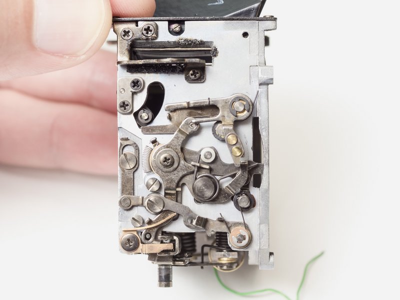

    4. Pentax ME Super Mirror Box Service, Problem areas: step 25, image 1 of 1
      • The rubber bushing under this screw causes the most problems. As it degrades it prevents the lever from moving freely leading to stuck mirrors and other malfunctions.
      • Removing this lever and cleaning out the old bushing is usually enough to get the camera functioning again.
      • Complete disassembly and cleaning out additional degraded bushings is recommended for the long term health of the camera.
      Ask FixBot
      • This is what a properly function mirror box should look like.
      • The mirror release latch, mirror return latch, and shutter release lever all move freely. The bias springs keep them in their ready positions.
      • The mirror is charged by pushing the large post on the bottom towards the front of the camera.
      • Push the mirror release latch up to start the cycle. The mirror should move quickly to the taking position.
      • Push the mirror return linkage and the mirror to should move to the viewing position.
      Ask FixBot

    13. Pentax ME Super Mirror Box Service, Remove air damper: step 35, image 1 of 3 Pentax ME Super Mirror Box Service, Remove air damper: step 35, image 2 of 3 Pentax ME Super Mirror Box Service, Remove air damper: step 35, image 3 of 3
      • Remove one c-clip.
      • Push mirror charge lever aside and remove air damper.
      • Separate the halves of the air damper and remove degraded rubber bumper.
      • Replace if new parts are available.
      Ask FixBot
  • To reassemble your device, follow these instructions in reverse order.
  • No lubrication is required for the mirror box mechanism. All of the pivot points are left dry.
  • A thick molybdenum grease can be used on the latching points to reduce wear.
