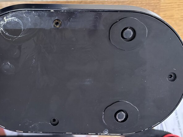

    3. Peltier Module for the Jura Cool Control 2.5L Model: step 3, image 1 of 2 Peltier Module for the Jura Cool Control 2.5L Model: step 3, image 2 of 2
      • Turn the unit upsidedown
      • Remove the five Phillips screws located on the underside.
      Ask FixBot

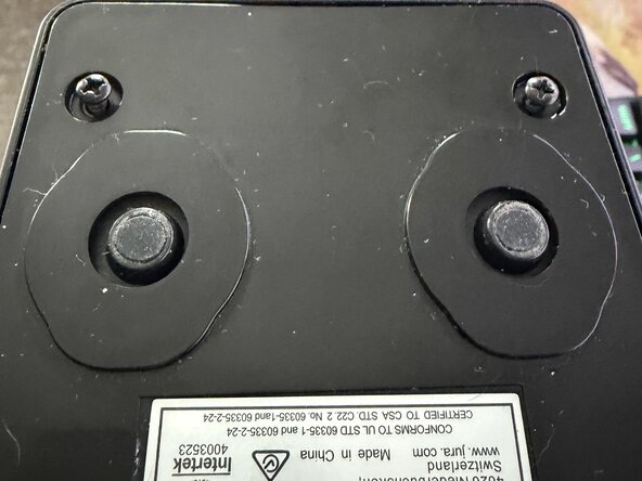

    4. Peltier Module for the Jura Cool Control 2.5L Model: step 4, image 1 of 1
      • Remove these two screws at the back of the unit underside.
      Ask FixBot

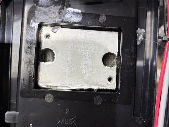

    7. Peltier Module for the Jura Cool Control 2.5L Model: step 8, image 1 of 3 Peltier Module for the Jura Cool Control 2.5L Model: step 8, image 2 of 3 Peltier Module for the Jura Cool Control 2.5L Model: step 8, image 3 of 3
      • Looking into the heatsink fins - there will be two small bits of foam resting on top of the screw heads. Remove the two small bits of foam using tweezers and keep them to one side.
      • Now unscrew the two screws.
      • Note: these screws may be incredibly difficult to unscrew due to moisture damage. Try using WD40 or Maintenance spray on the two screw heads, wait for 10 minutes and try unscrewing again.
      • With the two screws now removed. Carefully pull the heatsink off, away from the main unit.
      Ask FixBot

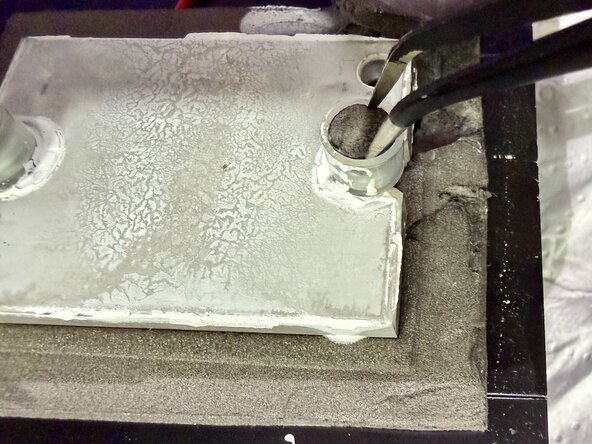

    9. Peltier Module for the Jura Cool Control 2.5L Model: step 10, image 1 of 3 Peltier Module for the Jura Cool Control 2.5L Model: step 10, image 2 of 3 Peltier Module for the Jura Cool Control 2.5L Model: step 10, image 3 of 3
      • Working on the rear of the removed heatsink. Remove the two foam caps that sit on top of the two screws.
      • Unscrew and remove the screws with a Phillips screwdriver.
      Ask FixBot

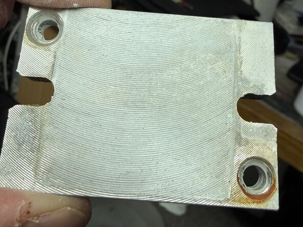

    10. Peltier Module for the Jura Cool Control 2.5L Model: step 11, image 1 of 3 Peltier Module for the Jura Cool Control 2.5L Model: step 11, image 2 of 3 Peltier Module for the Jura Cool Control 2.5L Model: step 11, image 3 of 3
      • Remove the metal block
      • This will reveal the Peltier module
      • Clean the block and remove the foam.
      • Note: you can remove the foam carefully with a plastic scrapping tool, if you want to re-use it. Or buy new adhesive polyethylene foam.
      Ask FixBot
